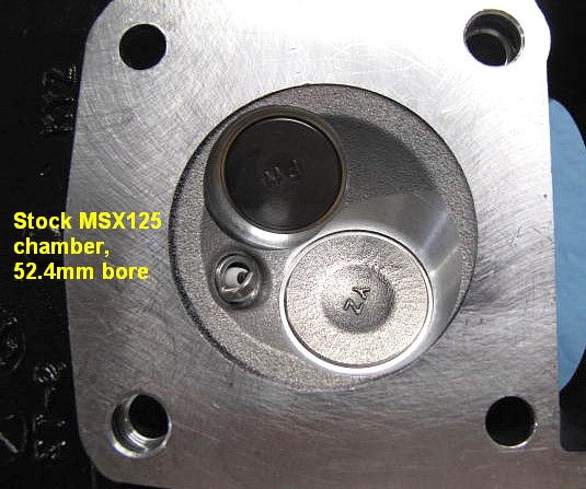

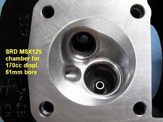

I got the Grom head tooling to the point that I could start modifying one of my spare Grom heads. The chosen bore is going to be 61mm for a displacement of 170cc. It will require a sleeve & a new steel head gasket, but the base gasket works, and you will not have to modify the crankcase. I machined a combustion chamber today that should be ideal for the bore. You could use the stock chamber, but you will not make the same power. This chamber is a fast burn design.

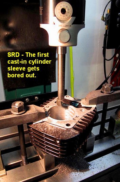

Why am I resleeving?
When Honda die cast the cylinder, they used a cast-in sleeve. That means they put a sleeve in the die, that has been pre-heated, shut the die, and then shoot aluminum into the die under very high pressure. So, unlike, say a CB750 Honda, where you could heat the cylinder in the kitchen oven when Mom was not around, and remove the sleeve, to re-sleeve the cylinder means boring out the cast in unit. Honda probably did not want people to bore the cylinder big, because the max bore in the stock cylinder is 136cc. They trimed down the outside of the sleeve that is exposed below the casting. What's inside the casting will go larger. They will claim that they were reducing weight, which they were, but they really limited the over bore. You could go to 142cc, but the skirt, or exposed sleeve would be thin, that's what the Japanese shop does. It does add money to the deal, but there is no real way around it.
The bottom line is that this engines needs torque, and that is displacement.
Brian S
