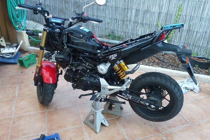

Setting up and a few rides later...
Setting up the new shock absorber was not too complicated, although removing the left side of the bike was somewhat tricky. You first have to remove the seat and then remove a number of screws that have been very strongly set and require good tools and a strong hand. In some places it is rather delicate to apply a lot of force without damaging the screw head while avoiding to bend the plastic more then it can withstand... One thing that fortunately was mentioned in the Ohlins instructions is a tiny plastic rivet located at the front, in the black inside curved portion. You have to push the center of the rivet with a nail or a small screwdriver to release it.
That done you have to remove the rear hugger and then you can access the top and bottom parts of the shock absorber. The bottom is not so bad even though you can't really have a plain and direct access to it. The top part is a bit trickier and i was glad to have some help from another pair of hands. Again the factory stuff has been very tightly set and you must be prepared to apply quite some force.
Once the original shock absorber is out of the picture, mounting the Ohlins is rather straightforward and putting things back together goes well. Don't forget the tiny rivet.
This Ohlins has two settings that can be adjusted: the spring preload which is supposed to be 7mm but looks like twice that out of the box, and the compression damping which recommended setting is 12 clicks. I kept things as they were for the first ride and although it did feel better then before i still found it a bit stiff for my little 117lbs. Since then i set the compression damping to 14 clicks and unscrewed the spring preload about 6mm (1/4 inch).
I've only been riding a few days with the new shock absorber, and i'm no expert of any kind on that matter, but i'm quite happy with the change, riding here and there, town, beach and hills - no racing. It is smoother then before, and at least i can play with the settings if i need to ride with a passenger for instance. There is still room for improvement on the front end though. :rolleyes:
