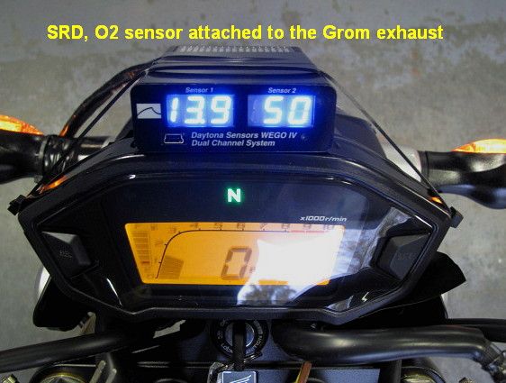

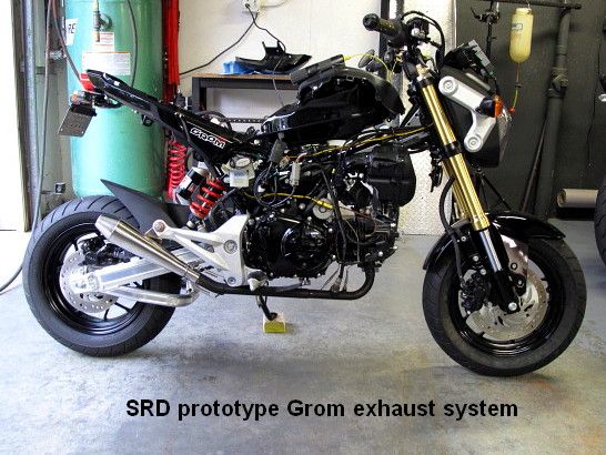

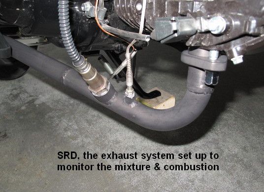

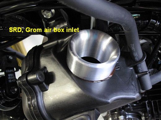

It's been a busy time these last two weeks. A Honda Grom cylinder is out to the production machineshop to time how long it takes to install the 61mm sleeve. The Grom SLS head gasket & a CMM dimension sheet went out to the gasket manufacturer. I thought I would post a few photo's of the prototype exhaust system, that I just finished. I got to ride it for the first time today. I finished my billet air box inlet, and mounted the O2 sensor. I was very courious how the ECM would react to the changes, and the decrease in back pressure. I also removed the gas tank vent system. So there were a few major changes. The ECU seemed to handle the changes in normal fashion. It ran most of the time at 14.0/1, 12.8/1 under hard accel, 14.7/1 backed off throttle @ 50 mph. What's interesting is that the exhaust gas temp never got over 780'F. I would have thought closer to 1100'F or 1200'F for a cat. engine program

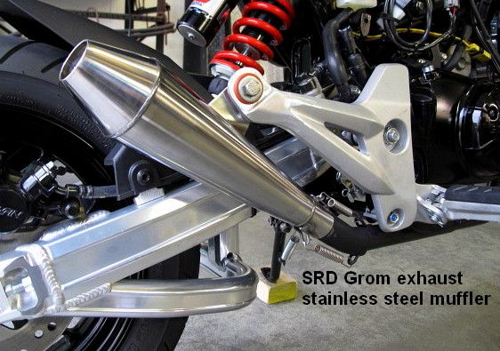

The base stainless muffler is from Cone with my welded bracket & spring mounts. It is too loud, nice tone, but too loud. I added a stainless washer to the end of the core, but it needs more. To be honest, the engine feels like it needs a little more back pressure on the bottom, Revised muffler this week. Please remember the main use for this exhaust is for the 170cc kit. I showed the dyno guy the Grom today, just to make sure it would fit on his dyno, it's so small. It will, with a little work, figure early Nov. I attached a air horn that I machined today to replace the extra rubber tubes in the air box. If you remove the 4" extension, without replacing the inllet, it will flow LESS air. There is a ledge inside the tube that needs to be filled in. I started to receive the components that I will need to re-engineer the swing arm pivots. By the end of the week, I'll have all the bearings & seals. It's a bit of a project, but I think it's worth doing. Anything can be made, but at what price point.

....I attached a air horn that I machined today to replace the extra rubber tubes in the air box. If you remove the 4" extension, without replacing the inllet, it will flow LESS air. There is a ledge inside the tube that needs to be filled in.
Hey Brian, loving your work.
I did the air box mod and was also worried about that lip left after removing the extention pipe.
Great solution there with the inlet horn.
